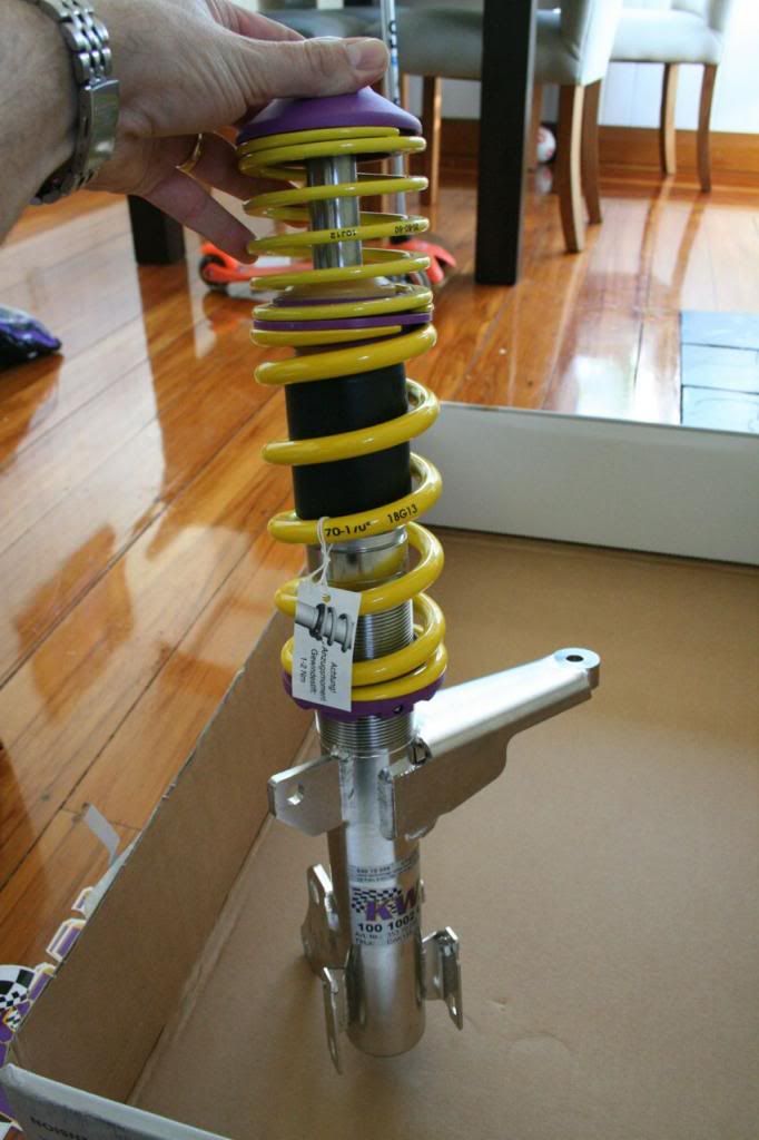

It was fitted and set up, wheel alignment done and a certifier was there to sign it off. Here is where it went off the rails I'm afraid. The certifier took one look and said 'I can't certify this as it has an an aftermarket welded steering arm' (see the last picture above, which shows a front strut with steering arm). It turns out this certifier did not have the approval to sign off steering modifications but he was doubtful about getting it certified at all. He then referred me to someone who had the required approval to cover steering modifications. I was also referred to this LVVTA article which outlines LVVTA concern with aftermarket welded steering arms: http://www.lvvta.org.nz/documents/infosheets/LVVTA_Info_05-2012_Welded_Aftermarket_Suspension_Struts.pdf

A possible solution is to cut the spring perches of a set of original struts, buy the threaded sleeves and just use the springs and hats of the kws, chuck them in and go get a cert and just refit the kws after. Bit of dicking around tho

Do you remember what the front strut looked like? Did it have welded or cast steering arms?

The bmws dont have the arms welded to the strut like the audis do. Kw move them down and point them inwards slightly to correct steering geometry when its lowered
